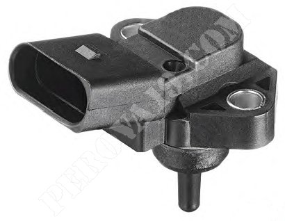

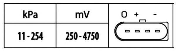

*Pressure transducer Powered by 5v from Arduino
* Pressure transducer signal attached to analog input 0
* at 0 pressure my pressure transducer reads 0.25v
* at 2.5 BAR (36.26PSI) my pressure transducer reads 4.75v
*28.24 value below is 1024/28.24 as i thought this would convert the input to PSI?
