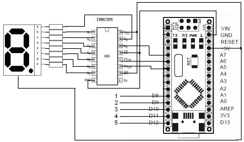

    Код 1. без регистра
    PHP код:
    int gear=0;
    char digit[] = {
    0b11000000//0
    0b11111001//1
    0b10100100//2
    0b10110000//3
    0b10011001//4
    0b10010010  //5
    void setup()
    PORTD 0x00;
    DDRD 0xFF;
    PORTB=0x1F;
    DDRB=0x00
    void loop()
      if(
    digitalRead(8)==0)gear=1;
      if(
    digitalRead(9)==0)gear=2;
      if(
    digitalRead(10)==0)gear=3;
      if(
    digitalRead(11)==0)gear=4;
      if(
    digitalRead(12)==0)gear=5;
    delay(80);
    PORTD digit[gear];
    Код 2. с регистром:
    PHP код:
    //connected to ST_CP
    int latchPin 3;
    //connected to SH_CP
    int clockPin 4;
    //connected to DS
    int dataPin 2;
    int gear =0;
    int digit[] =
    192//0
    249//1
    164//2
    176//3
    153//4
    146};//5
    void setup()
    pinMode(latchPinOUTPUT);
    pinMode(clockPinOUTPUT);
    pinMode(dataPinOUTPUT);
    PORTB=0x1F;
    DDRB 0x00;
    void loop()
        if(
        if(
        if(
        if(
        if(
    delay(80);
    digitalWrite(latchPinLOW);
    shiftOut(dataPinclockPinMSBFIRSTdigit[gear]);
    digitalWrite(latchPinHIGH);
