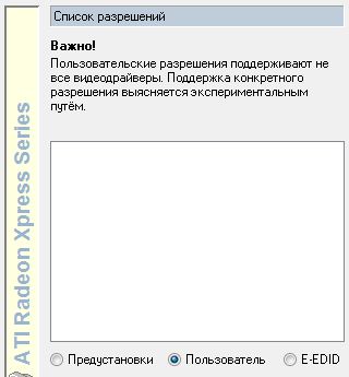

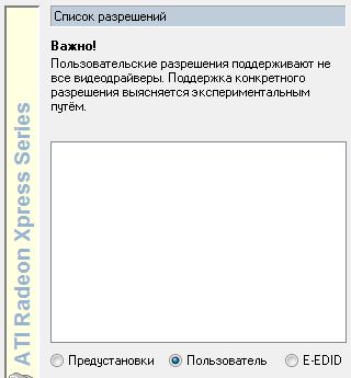

    PowerStip -> Профили дисплея –> Настроить -> Дополнительные параметры -> Другие разрешения -> Пользователь.
    Будет пустое окно в которое добавляете свои придуманные разрешения установленные в правой части окна (новое разрешение).
    Ставим галочки
    Нажимаем

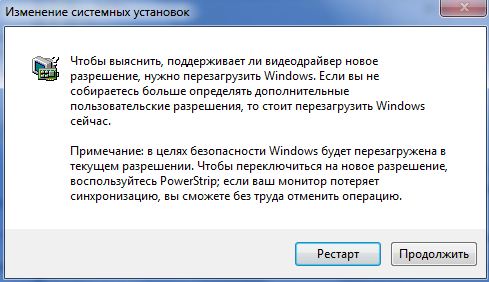

    В появившемся окне жмем "Рестарт" (для добавления нового разрешения в реестр).

    2. PowerStrip menu > Display profiles > Configure > Advanced timing options > Custom resolutions
    3. Select the "User defined" list of timings (above the "Remove resolution" button)
    4. Select *all* the resolutions you want to restore (this is a standard Windows multi-select list box)
    5. Click "Add resolution" and follow the instructions on screen - PowerStrip will restore all the information lost in the process of install the new driver

    12. If the resolution you created is already supported by the display driver for, e.g., DirectX, PowerStrip will give you the option of switching to the resolution now; otherwise you'll need to reboot to see if the driver will support the resolution
    If everything is Ok, you can switch the desktop to the resolution you just created by using the Windows shortcut you just created.
    Note: if your display driver does not support custom, user-defrined resolutions, you can still run the desktop at a lower resolution, but you'll be limited to resolutions (and possibly timings) that the driver already supports for DirectX. You can create a standard PowerStrip display profile, with or without a Windows shortcut, to switch to the resolution.
